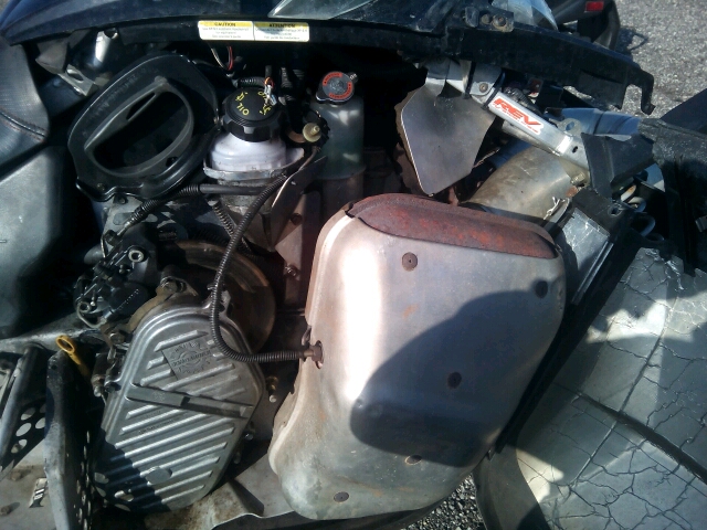

OK, first things 1st.... here's a couple pics...
Yep, sure looks like a 2004 GSX to me.... or what's left of one anyway... OK, now the VIN.... from 2000-up they are a 17-digit number

So if you wanted to just go by the VIN number here, you're screwed... however, A couple things also give away the engine if you know the sleds... first & most obvious is the thermocouple in the muffler which only the fuel injected sleds have.
Second is that it has the large multi-pin connector ECM & the large fuse/relay box next to it, which is only found on the 600-SDI prior to 2006, rather than the usual multi-connector MPEM on 2000-05 sleds.
So, unfortunately for this example... it's not a 500ss & is indeed the 600HO-SDI engine, in a 2004 GSX Sport.
