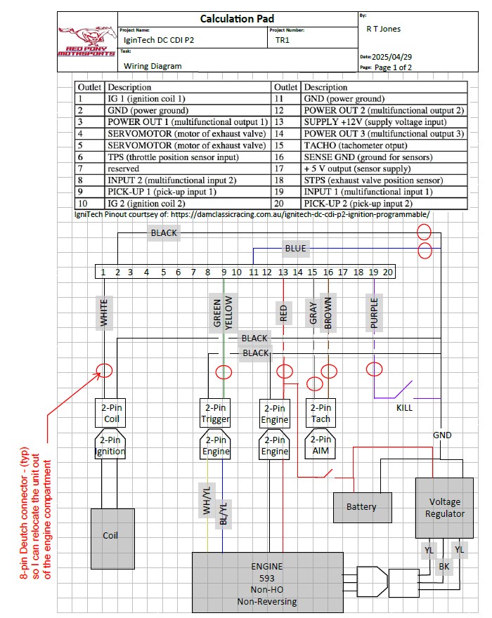

Here is a wiring diagram for the Rotax 593 engine, thanks to R T Jones.
