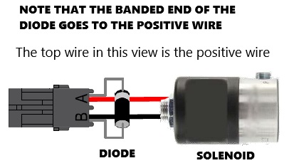

TRANSIENTS
Transients are generated by power devices, such as solenoids, relays and coils, and are most harmful to control devices. Transients can be managed with the use of diodes across the coils, as well as proper wiring techniques. Every solenoid or relay in the car should have a suppression diode installed, some relays, or controllers, MAY have the diode built, others may not. Simply changing a relay, could cost you weekends of failed racing. We recommend, and there is no harm in, adding a diode as insurance, not to mention it may improve the performance of a coil-driven device.
Showing Diode on Solenoid-1.jpg (30.06 KiB) Viewed 16040 times

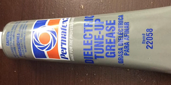

A small amount of this tune-up grease on the bolt and terminals will prevent corrosion.
DO NOT put a star washer between the ground stud and the battery cable. There are some opinions on this subject, but trust me, putting a star washer under the cable terminal is bad idea.

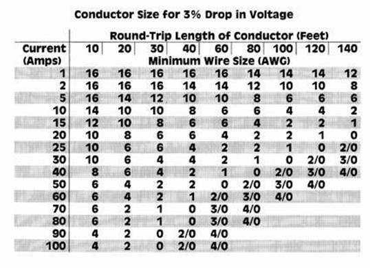

Voltage Drop
There will always be some voltage drop in a conductor due to current in the conductor.
• See the charts below.
Voltage drop on a wire.png (80.63 KiB) Viewed 16039 times
An important consideration on the selection of wire gauge VS wire length VS current in the wire.
Current capability vs Wire Size.jpg (60.97 KiB) Viewed 16039 times
NOTE: Notice that the above chart mentions “round trip” Keep in mind that any current
that flows from the positive battery terminal must return to the negative terminal via the ground wire.
• So, when you calculate your wire length, remember to add in the length of the ground or return wire.

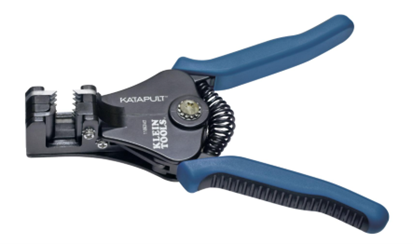

Wire Strippers
Klein Tools Automatic Wire Strippers.png (78.83 KiB) Viewed 16035 times
Klein Tools Automatic Wire Strippers Part Number: KLE-11063-W
If you don’t want to pop for this really nice Klein tool above, this one below will work. Very similar to the one I use:
Wire Strippers.png (56.82 KiB) Viewed 16035 times
Whatever wire striper you buy, make sure that it has a locking feature, you don’t want this open floating around in your toolbox. I found this at Lowes.

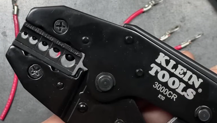

Crimping is the process of joining two conductors (wire or cable) by deforming a metal connector tightly around them. When done correctly, crimping creates a permanent, secure electrical connection that is more reliable than soldering. Proper crimps ensure a consistent current flow and can withstand vibrations and pulling in harsh environments.
The core of any good crimp job is the right crimping tool matched to the connector type and wire gauge.
I can’t recommend this crimper
Bad Crimper.png (297.53 KiB) Viewed 16035 times
Good Klien Crimper.png (189.92 KiB) Viewed 16035 times
I recommend this tool for crimping both insulated and non-insulated terminals
• This tool has replaceable jaws for both insulated and non-insulated

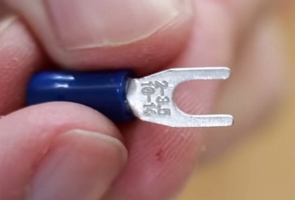

Here is a fork terminal showing the wire gauge.jpg (16.65 KiB) Viewed 16035 times
Here is a fork terminal showing the wire gauge (18-16), that will work with this terminal.

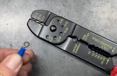

Use the color-code chart below for heat-shrink butt/ferrule terminals:
Wire Gauge (AWG)...Connector Color.........Typical Use
22–18............................Red.......................Small wires (ground wires, signal)
16–14............................Blue......................Medium wires (12–14 AWG splices)
12–10............................Yellow....................Large wires (battery cables, high
......................................................................Current circuits)

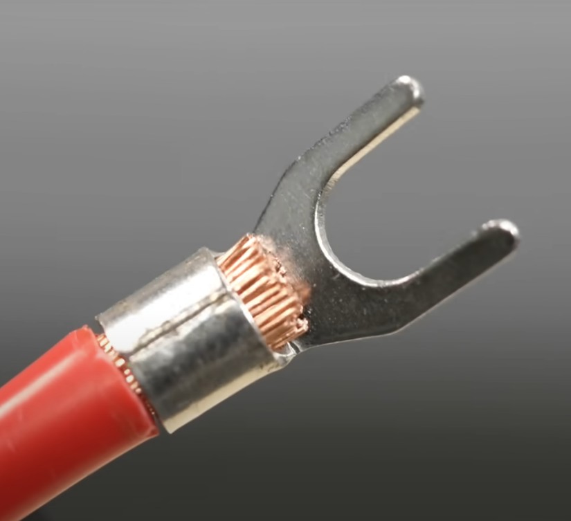

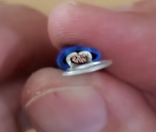

An example of a good crimp on a insulated terminal.jpg (19.17 KiB) Viewed 16035 times
An example of a good crimp.jpg (9.67 KiB) Viewed 16035 times
Showing good crimp on insulated terminals
What a good crimp should look like-bottom view.jpg (42.6 KiB) Viewed 16035 times
What a good crimp should look like-top view.jpg (44.48 KiB) Viewed 16035 times
Showing good crimp on both sides of a fork terminal

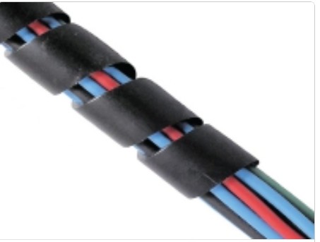

TYPES OF WRAPS
Spiral Wrap Tubing.jpg (17.82 KiB) Viewed 16027 times
Spiral Cable Wrap Tubing
Split Tubing.jpg (22.06 KiB) Viewed 16027 times
Split Wire Loom
Spiral wrap tubing offers a unique solution for securing and protecting multiple cables or wires while allowing for easy access and adjustability. The spiral design enables cables to branch out at any point, making it ideal for complex wiring setups that require flexibility. It is particularly useful in applications where cables need to be bundled and protected from abrasion or harsh environments while still maintaining accessibility for maintenance and modifications. Spiral wrap tubing is versatile, whether used in industrial, automotive, or office environments, offering the perfect balance between protection and ease of use.

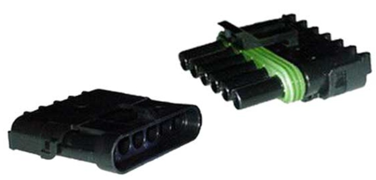

Weather Pack Connectors *3
Weather Pack is an environmentally sealed electrical connection system designed to withstand exposure to extreme temperatures, moisture, and harsh engine compartment fluids and chemicals. They are extensively used in severe duty applications including racing, construction, off-road, and industrial equipment. The connectors are made of a nylon material for the best combination of temperature resistance and flexibility. They have been tested to withstand temperatures of -40C to 125C. The terminals are tin-plated and utilize flex pin and lap lock designs to provide the highest reliability. Their dual locking tangs securely hold the terminal inside the connector cavity. Weather Pack self-lubricating seals feature multiple sealing ribs and will not stain, deteriorate or corrode other materials.
The Weather Pack connectors are available in 1 to 6 terminals.

Six Cavity Weather Packs
Weather Pack six pin housing.jpg (33.34 KiB) Viewed 16025 times
